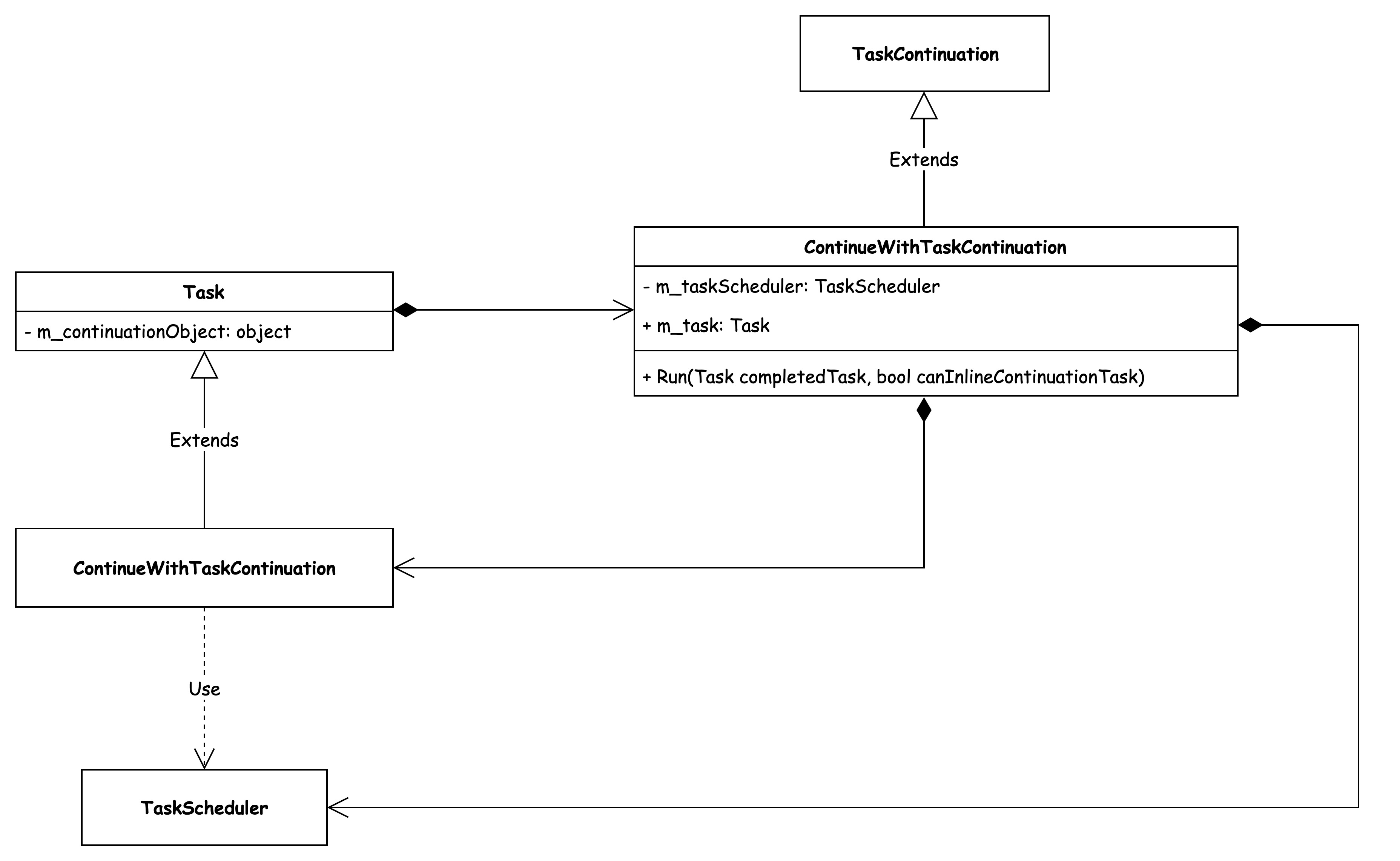

ContinueWithTaskContinuation 的父类 TaskContinuation 是一个抽象类。除了 ContinueWithTaskContinuation,还有别的实现。
internal abstract class TaskContinuation
    internal abstract void Run(Task completedTask, bool canInlineContinuationTask);
ContinueWithTaskContinuation 维护着 Task 执行相关的两个核心对象,一个是 Task 本身,另一是 TaskScheduler。真正执行回调之前,需要先调用 TaskContinuation.Run。
internal sealed class ContinueWithTaskContinuation : TaskContinuation
    internal Task? m_task;
    internal readonly TaskContinuationOptions m_options;
    private readonly TaskScheduler m_taskScheduler;
    internal ContinueWithTaskContinuation(Task task, TaskContinuationOptions options, TaskScheduler scheduler)
        m_task = task;
        m_options = options;
        m_taskScheduler = scheduler;
    internal override void Run(Task completedTask, bool canInlineContinuationTask)

回调执行真正的决定者:ContinueWithTaskContinuation
在 ContinueWithTaskContinuation 中维护着待执行的 ContinuationTask 以及决定 ContinuationTask 最终执行方式的 TaskContinuationOptions 和 TaskScheduler。
        m_task = task;
        Task? continuationTask = m_task;
        m_task = null;
        // 检查任务的完成状态,如果不符合 TaskContinuationOptions 的设置,回调就不会被执行
        TaskContinuationOptions options = m_options;
        bool isRightKind =
            completedTask.IsCompletedSuccessfully ?
                (options & TaskContinuationOptions.NotOnRanToCompletion) == 0 :
                (completedTask.IsCanceled ?
                    (options & TaskContinuationOptions.NotOnCanceled) == 0 :
                    (options & TaskContinuationOptions.NotOnFaulted) == 0);
        // 任务完成状态符合要求,回调执行。
        if (isRightKind)
            continuationTask.m_taskScheduler = m_taskScheduler;
            // 直接执行回调或将其排队等待执行,具体取决于是否需要同步或异步执行。
            // 默认执行路径,上层传的是 true。
            if (canInlineContinuationTask && // 调用Run方法的内部方法传了允许内联
                (options & TaskContinuationOptions.ExecuteSynchronously) != 0) // 注册回调的实际用户设置了同步执行
                InlineIfPossibleOrElseQueue(continuationTask, needsProtection: true);
            else
                try { continuationTask.ScheduleAndStart(needsProtection: true); }
                catch (TaskSchedulerException)
                    // 如果 Task 执行失败了,ScheduleAndStart 方法会将 Task 标记为失败,
                    // 这里是runtime设计的时候保证不会有意外的错误发生,仅做catch,不做处理
        else
            Task.ContingentProperties? cp = continuationTask.m_contingentProperties;
            if (cp is null || cp.m_cancellationToken == default)
                continuationTask.InternalCancelContinueWithInitialState();
            else
                continuationTask.InternalCancel();

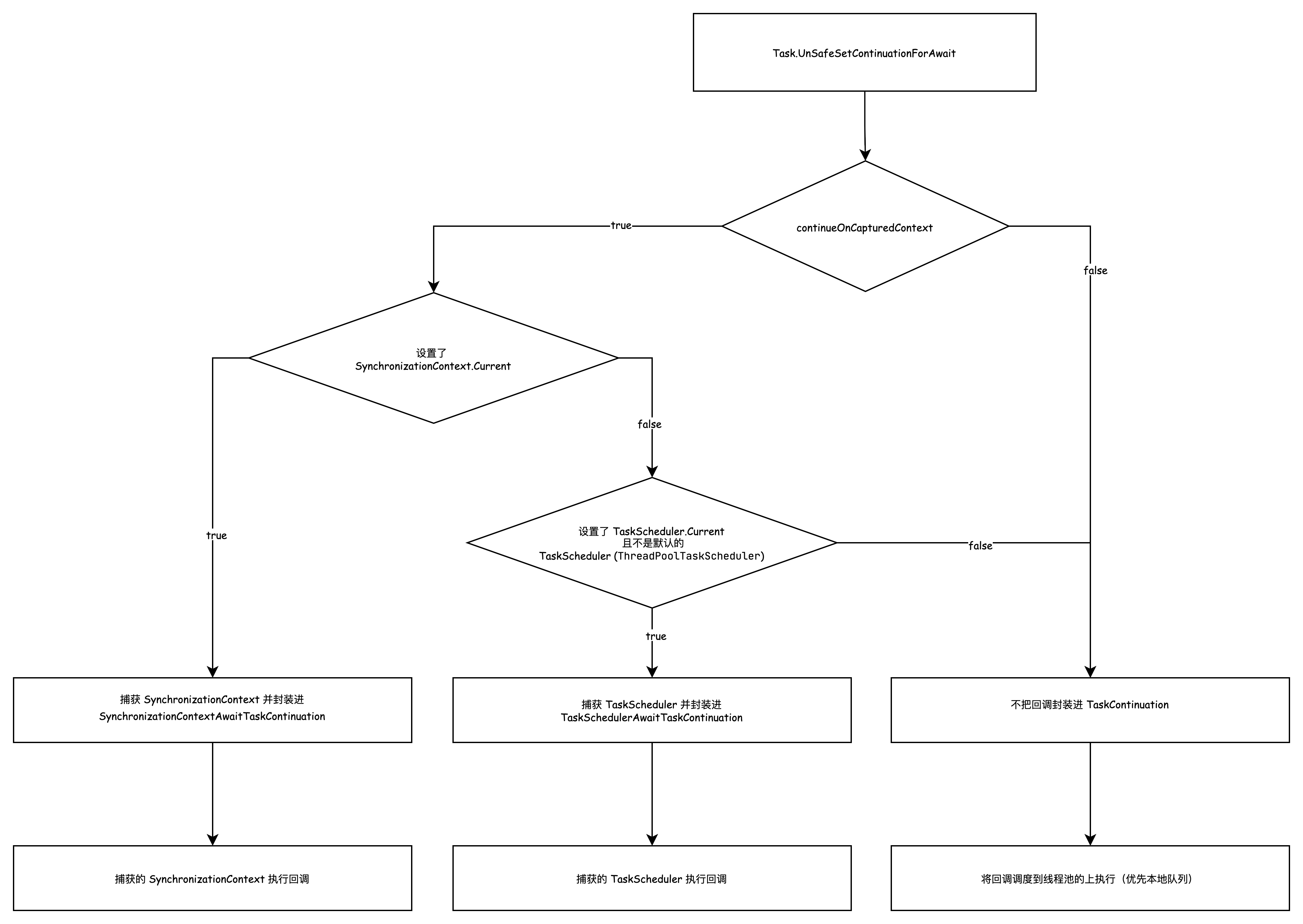

    internal void SetContinuationForAwait(
        Action continuationAction, bool continueOnCapturedContext, bool flowExecutionContext)
        TaskContinuation? tc = null;
        if (continueOnCapturedContext)
            SynchronizationContext? syncCtx = SynchronizationContext.Current;
            if (syncCtx != null && syncCtx.GetType() != typeof(SynchronizationContext))
                tc = new SynchronizationContextAwaitTaskContinuation(syncCtx, continuationAction, flowExecutionContext);
            else
                TaskScheduler? scheduler = TaskScheduler.InternalCurrent;
                if (scheduler != null && scheduler != TaskScheduler.Default)
                    tc = new TaskSchedulerAwaitTaskContinuation(scheduler, continuationAction, flowExecutionContext);
        if (tc == null && flowExecutionContext)
            tc = new AwaitTaskContinuation(continuationAction, flowExecutionContext: true);
        if (tc != null)
            if (!AddTaskContinuation(tc, addBeforeOthers: false))
                tc.Run(this, canInlineContinuationTask: false);
        else
            if (!AddTaskContinuation(continuationAction, addBeforeOthers: false))
                AwaitTaskContinuation.UnsafeScheduleAction(continuationAction, this);

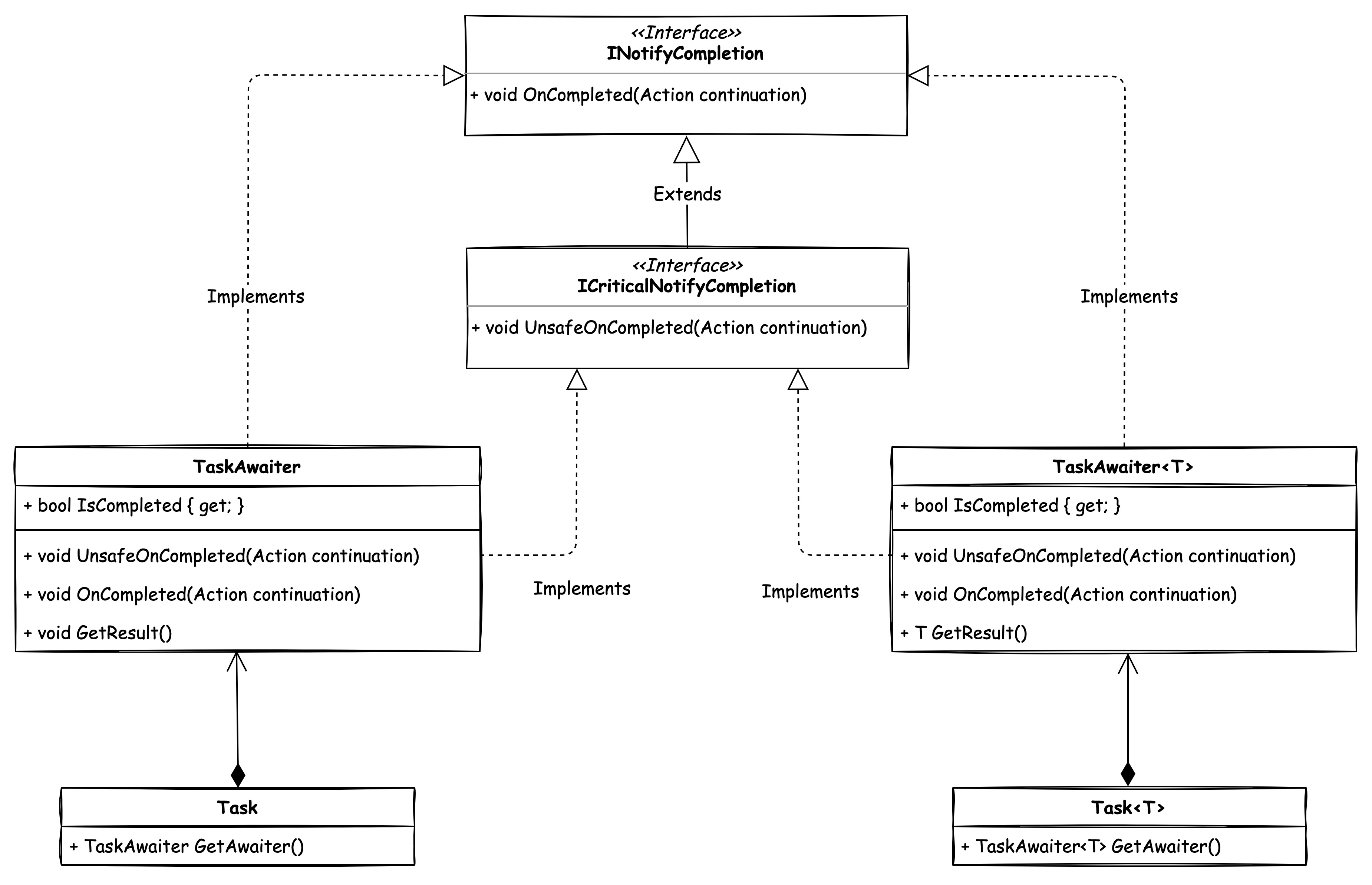

public readonly struct TaskAwaiter<TResult> :
    ICriticalNotifyCompletion,
    INotifyCompletion,
    ITaskAwaiter
    private readonly Task<TResult> m_task;
    internal TaskAwaiter(Task task)
        m_task = task;
    public bool IsCompleted => m_task.IsCompleted;
    public void OnCompleted(Action continuation)
        TaskAwaiter.OnCompletedInternal(m_task, continuation, continueOnCapturedContext: true,
    public void UnsafeOnCompleted(Action continuation)
            flowExecutionContext: false);
    [StackTraceHidden]
    public TResult GetResult()
        TaskAwaiter.ValidateEnd((Task)this.m_task);
        return this.m_task.ResultOnSuccess;
    internal static void OnCompletedInternal(
        Task task,
        Action continuation,
        task.SetContinuationForAwait(continuation, continueOnCapturedContext, flowExecutionContext);

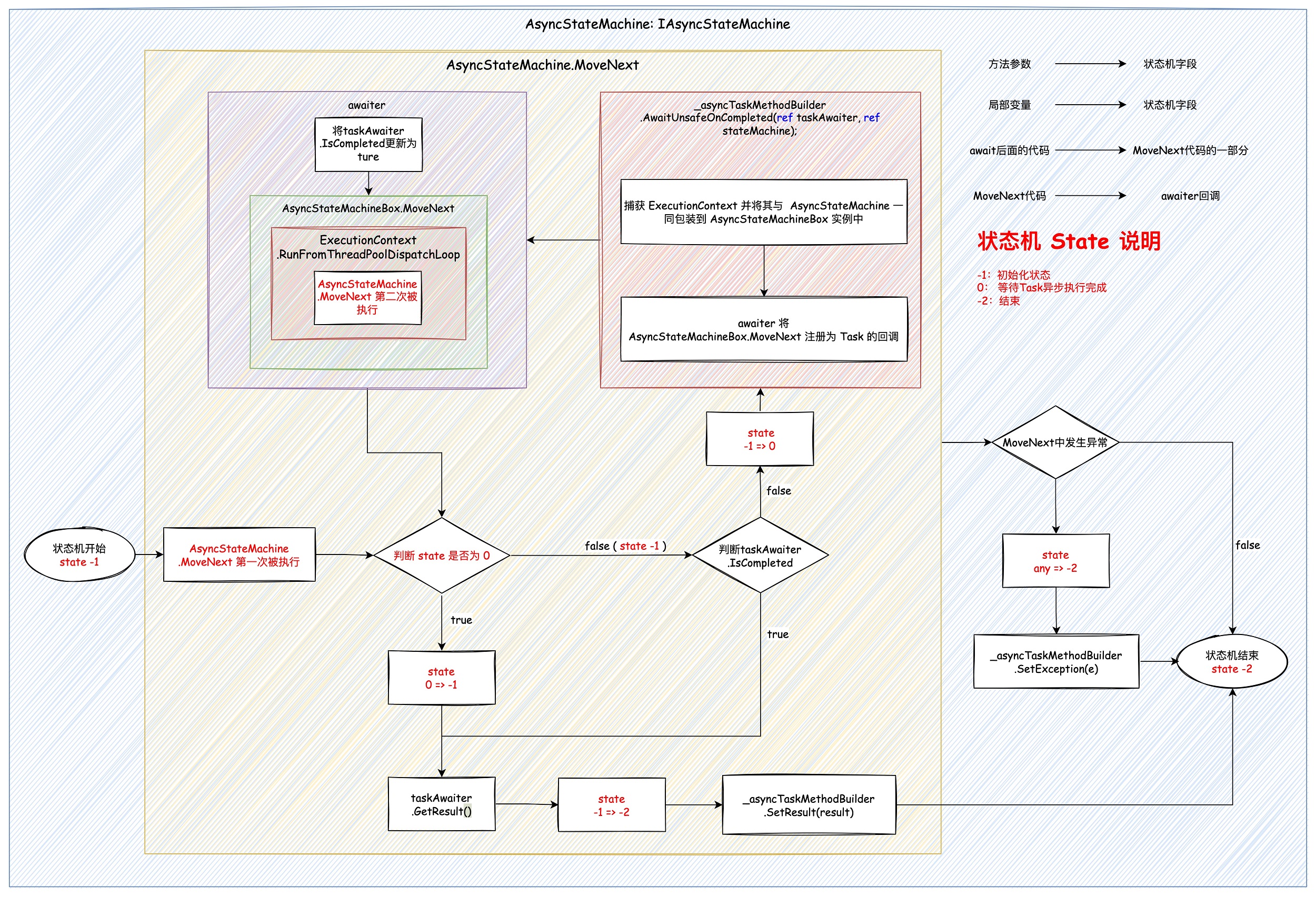

可以看到 TaskAwaiter.OnCompleted 就是往 Task 注册回调,而 await 关键词的本质就是把 await 后面的代码变成了回调并注册到了 Task 上。
Task.Run(() => "Hello")
    .ContinueWith(t => Console.WriteLine($"{t.Result} World"));
// 等效于
var result = await Task.Run(() => "Hello");
Console.WriteLine($"{result} World");
// 等效于
Task.Run(()=> "Hello").GetAwaiter().OnCompleted(()=> Console.WriteLine("World"));

  1. ICriticalNotifyCompletion,INotifyCompletion 这两个接口。而 ICriticalNotifyCompletion 是 INotifyCompletion 的子接口。
public interface INotifyCompletion
    void OnCompleted(Action continuation);
public interface ICriticalNotifyCompletion : INotifyCompletion
    void UnsafeOnCompleted(Action continuation);
  1. 提供 IsCompleted 属性 和 void GetResult() / TResult GetResult() 方法。GetResult 方法是否有返回值取决于 await XXXAwaitable 是否想提供返回值。
实际上,我们自己想要实现一个 Awaitable 的话,Awaiter 只需要实现 INotifyCompletion 接口或者 ICriticalNotifyCompletion 就可以了。

观察下面这么一个常见的 await 使用场景,可以将 FooAsync 方法内部的逻辑分为三种状态(即 三个阶段):
  1. 初始化状态
  2. 等待 BarAsync 执行完成的状态
  3. 执行结束状态
class Program
    static async Task Main(string[] args)
        var a = 1;
        Console.WriteLine(await FooAsync(a));
    static async Task<int> FooAsync(int a)
        int b = 2;
        int c = await BarAsync();
        return a + b + c;
    static async Task<int> BarAsync()
        await Task.Delay(100);
        return 3;
由 FooAsync 编译成的 IL 代码经整理后的等效 C# 代码如下:
using System;
using System.Runtime.CompilerServices;
using System.Threading.Tasks;
class Program
        var a = 1;
    static Task<int> FooAsync(int a)
        var stateMachine = new FooStateMachine
            _asyncTaskMethodBuilder = AsyncTaskMethodBuilder<int>.Create(),
            _state = -1, // 初始化状态
            _a = a // 将实参拷贝到状态机字段
        // 开始执行状态机
        stateMachine._asyncTaskMethodBuilder.Start(ref stateMachine);
        return stateMachine._asyncTaskMethodBuilder.Task;
        return 3;
    public class FooStateMachine : IAsyncStateMachine
        // 方法的参数和局部变量被编译会字段
        public int _a;
        public AsyncTaskMethodBuilder<int> _asyncTaskMethodBuilder;
        private int _b;
        private int _c;
        // -1: 初始化状态
        // 0: 等到 Task 执行完成
        // -2: 状态机执行完成
        public int _state;
        private TaskAwaiter<int> _taskAwaiter;
        public void MoveNext()
            var result = 0;
            TaskAwaiter<int> taskAwaiter;
            try
                // 状态不是0,代表 Task 未完成
                if (_state != 0)
                    // 初始化局部变量
                    _b = 2;
                    taskAwaiter = Program.BarAsync().GetAwaiter();
                    if (!taskAwaiter.IsCompleted)
                        // state: -1 => 0,异步等待 Task 完成
                        _state = 0;
                        _taskAwaiter = taskAwaiter;
                        var stateMachine = this;
                        // 内部会调用 将 stateMachine.MoveNext 注册为 Task 的回调
                        _asyncTaskMethodBuilder.AwaitUnsafeOnCompleted(ref taskAwaiter, ref stateMachine);
                        return;
                else
                    taskAwaiter = _taskAwaiter;
                    // TaskAwaiter 是个结构体,这边相当于是个清空 _taskAwaiter 字段的操作
                    _taskAwaiter = new TaskAwaiter<int>();
                    // state: 0 => -1,状态机恢复到初始化状态
                    _state = -1;
                _c = taskAwaiter.GetResult();
                result = _a + _b + _c;
            catch (Exception e)
                // state: any => -2,状态机执行完成
                _state = -2;
                _asyncTaskMethodBuilder.SetException(e);
                return;
            // state: -1 => -2,状态机执行完成
            _state = -2;
            // 将 result 设置为 FooAsync 方法的返回值
            _asyncTaskMethodBuilder.SetResult(result);
        public void SetStateMachine(IAsyncStateMachine stateMachine)
编译器在 Program 中创建了一个内部类,也就是 FooStateMachine 这个状态机,而 FooAsync 方法则变成了对这个状态机的使用。
AsyncTaskMethodBuilder 的作用解释放到下一篇文章再解释,这边简单理解成 AsyncTaskMethodBuilder.SetResult 就是 FooAsync return 返回值,AsyncTaskMethodBuilder.SetException 就是 FooAsync 内部往外扔异常。
完整的流程如下图所示:
一个方法中就算有个 await,这个方法也只会有一个对应的状态机。就.NET 6 SDK 的编译结果来看,state 会出现 -1 => 0(等待第一个Task异步执行完成) => -1 => 0(等待第二个Task异步执行完成)这样的流程。
AsyncStateMachineBox
前文讲过 awaiter 往 Task 注册回调的逻辑里,可能不会直接传递 ExcutionContext。
而这个 AsyncStateMachineBox 是对 AsyncStateMachine 和 ExcutionContext 的包装,这边通过这样的方式往后传递 ExcutionContext。
await Task 的回调在哪执行
回忆一下上文 Task.ContinueWith 讲回调最终封装到了 ContinueWithTaskContinuation。
返回值是 Task 的情况下状态机所绑定的 AsyncTaskMethodBuilder 的所会调用 Task.UnsafeSetContinuationForAwait 实例方法。里面会根据不同的条件创建不同的 TaskContinuation。
UnsafeSetContinuationForAwait 中的逻辑和后续回调执行流程大致如下:
值得注意的是,当前上下文设置的 TaskScheduler 并不能通过 TaskScheduler.Current 获取,而应该通过 TaskScheduler.InternalCurrent 获取。
TaskScheduler InternalCurrentTaskScheduler()
    var propertyInfo = typeof(TaskScheduler).GetProperty("InternalCurrent", BindingFlags.Static | BindingFlags.NonPublic);
    return (TaskScheduler)propertyInfo.GetValue(null);
如果 TaskScheduler.InternalCurrent 为 null,TaskScheduler.Current 会返回 TaskScheduler.Default,也就是 ThreadPoolTaskScheduler。
public class TaskScheduler
    public static TaskScheduler Current => InternalCurrent ?? Default;
